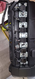

Hello everybody, I am in the process of installing B58 coil packs on my turbo E46. I just finished the hardware side of things and am moving onto the tune. I was able to get the dwell times through a damos file, but I cannot find if there are dwell times for multispark. Any help would be appreciated, thank you.
Link in case anybody wants more info: https://turboe46.blogspot.com/p/b58s58-coil-pack-retrofit.html

I remember Justin (V8bait) was into the development for the PR (?) coils. And he for sure is the man when it comes to tables, lol.
If he does not reply to this post, you may just send him a PM.
