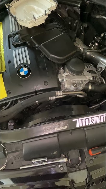

You'd have to pull you radiator fan out, then it'll be the 22mm bolt in the crank pulley. Although you might have space to do this without pulling the fan as your single turbo.
Yeah I'm used to pulling the fan out, takes like a minute since one of my tabs were broken lol. So if I want to see if it backed out, I would simply try tightening it then on the crank bolt to see if it moves? Or loosen?
Also is this the same method as "cranking" if I were to fix the timing on my car by making sure cyl 1 is TDC? Sorry I get a little confused because it makes me think I am either tightening or loosing that crank bolt.

If you try to tighten the crank bolt and it spins without rotating the engine, it would mean the bolt had come loose. And sorry i did exactly understand the second part.
Yeah it's hard to explain over text lol, would you mind shooting me a text a 616-312-3725? I'd figure it might be easier to explain over phone haha.
